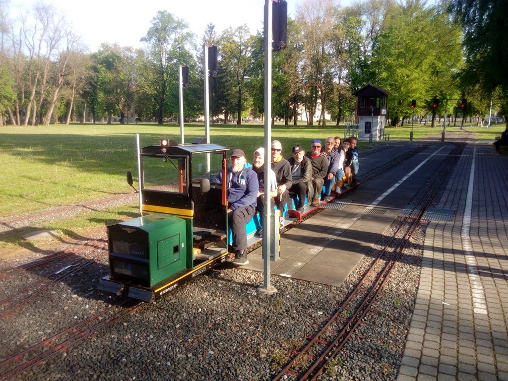

Malom motornjaku struju za elektromotor daje jedan generator, dakle on je benzinsko-električna lokomotiva
![Zagrebački tramvaj M 24 u mjerilu 1:6 AM-JKLUjUuBey9L8hYYTM0flruZW7Hz3x58Nmr_RiXkGLdQolNDKrx52hIRZOUIPwvhHfSB4erYhQfF0Kv376eqAE6MMvOJjv-3KkHY6rq-LPoT6YiqK0on3fwLrLidj5fyJ219F9SmUujaZHTMw0R26y8KDWg=w678-h903-no?authuser=0](https://lh3.googleusercontent.com/pw/AM-JKLUjUuBey9L8hYYTM0flruZW7Hz3x58Nmr_RiXkGLdQolNDKrx52hIRZOUIPwvhHfSB4erYhQfF0Kv376eqAE6MMvOJjv-3KkHY6rq-LPoT6YiqK0on3fwLrLidj5fyJ219F9SmUujaZHTMw0R26y8KDWg=w678-h903-no?authuser=0)
Sposoban je bez problema povući 10-ak odraslih ljudi
